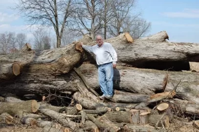

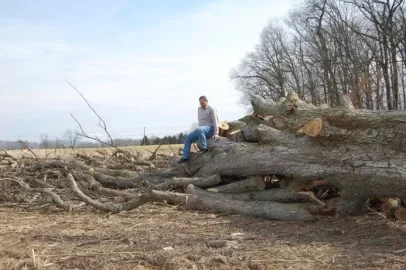

I was telling a friend that I was given two nice size red oak trees that had blown down and that I intended to have them sawn into timbers for a cabin I have planned. He said he knew someone that had just had a large oak cut down and wanted to get rid of it. He gave me the guy’s number and I called him. I asked this guy how far up the first limb was. He said it was only about 8 feet to the first limb so I’m thinking that this tree is not going to be worth my time. Then I ask what diameter the tree is. He says 4 or 5 feet. I say no, not how far all the way around the tree, how far is it if you measure straight across? He says 4 or 5 feet. I decide I better have a look. Turns out the stump, oval in shape, is 4 feet the small way and 6 feet the large way. The tree measures 13 feet in circumference at breast height. His son in law wants all the small limbs (16” and less) for fire wood but no one wants the remainder. I haven’t decided yet if I want any of it, but it’s tempting. There are two limbs that would be worthwhile to have sawn. One is about 18” in diameter and the other is about 24”. Neither of them are more than about 9 feet in length to avoid all smaller limbs. The butt log could potentially be quartered with a chain saw. Has anyone ever done this? I have no interest in the remainder. I’m guessing that he will have to get a dozer or some other large piece of equipment to push it into the nearby woods. It’s currently lying in his corn field. Even after quartering the butt log I think I could have it quarter sawn and end up with a few boards in exess of 20" wide. Anyone have words of encouragement or am I crazy for even thinking about it?

You have to be out of your ever-loving mind to try it. I would have started already.
If you're talking about chainsaw ripping the butt log into quarters, you are indeed in for an experience. If your saw is powerful enough to use a bar long enough to go halfway you might try getting a skip-tooth ripping chain just for this project. Chainsaw sawmill suppliers might have them. Drive wedges into the cut as you go in case it tries to close up on your bar.
Look around at the other trees in that hedgerow. Any sign of fence wire and I'd get skeptical.
Of course, if someone around you has one of these, it could be split into whatever you want.
http://www.timberwolfcorp.com/log_splitters/default.asp?id=15
Any log trucks in your area that have a boom that could load that butt log and take it somewhere to quarter and saw it?
Well, all those limbs sprouting off would make the grain fun to use with handtools.
Limbs are compression wood so they are likely to move on you.
Have at it.
Matt
Damn!!!!!!! I just took 4 advil and two beers just from looking at that monster!
That sure will be a handful.
KC
How much powder would you use, and how fast to run.
How often do you have the chance at a 20" wide piece of Quarter Sawn? How long would they be?

I would seriously find a wood artisan who would want an enormous chunk of wood. They could make an entire piece of furniture just by carving it out of one huge section. It would be spectacular to see all of the seemless grain on one piece of furniture. Even if you could get a bunch of cross sections to utilize as table tops it would look awesome. This all depends on the condition of the wood.
Here's the way I look at it. If this is what you have for wood then you go for it. Take your time and rip it long ways and take out pie shaped logs until you can't do it anymore. However, if this is just extra then I would surely pass. It all depends on what you've got on hand. The more you've got the pickier you can get. By the time you get that monster cut up you'll have a ton of wood chips leftover. Back when I had no wood I would have taken it on, but now it just looks like a big headache.
Boy I'd love to have than sitting in my back yard, it would be fun to dig into at my leisure with the 3120 or 880.
I have to admit some of the old monster butt logs I've sawn into lumber produced some pretty unstable wood. You could cut boards out at 5/4 or 6/4 so they could warp and twist a bit and still be used with a bit of jointer and planer work.
Do you have any large portable bandsaw mills down there? They might want to try it just for the challenge.

Lots of good ideas presented. Thanks to all. I think I’ll save the black powder option as a last resort. :ahhh: Someone mentioned the possibility of fence wire and that was a concern I had also. There is no sign that there had been any fence in the area but since the tree is easily over 100 years old there is no way to be sure.
The most encouraging information came from Constrictor. I didn’t realize any of the red oaks got that big. He also mentioned an 044 which is similar to my 460. The manual says my 460 can handle a 32” bar. I think it would be best to do as much of the cutting as possible with my 20” bar and just get those last few inches with the long bar. Way more control I would think. I priced a 32” bar and chain. It’s about $100. Not a big deal if all goes well. That’s a big “if” at this point but I think I’m going to tell the guy that I’m going to give it a go. At the very least I’ll get those two nice size limbs.
A couple of folks seem to be under the impression that I would be using this for firewood. That is definitely not the case as I have plenty of black locust on my own farm that is much easier to get. I am thinking more along the lines of using this quarter sawn lumber for the floor of my cabin. I plan to timber frame the cabin and wide quarter sawn lumber would look outrageous on the floor.
Is that 29 FACE cords of black locust?
Dave,
That’s bad news about the possibility of this wood being unstable. I was reading up on quarter sawn lumber and it is supposed to be more stable than any other way of sawing but I didn’t consider that the size of this tree could have some bearing on that. The farmer next to me has a wood mizer band saw mill and I was planning on him sawing all the timbers for the cabin but I don’t know if his machine is large enough for this butt log.

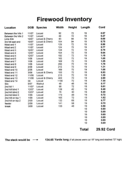

No, not face cord and I’m close to 30 now. Below is my current inventory list. I’ll have to take a picture of stack 14 at the west end of my property. At nearly 100 feet long it’s an impressive site.

A firewood inventory spreadsheet? Now I've seen it all! I like the way you've got them all measured out and everything. Me, I'm lucky to even get the darned stuff stacked, much less catalogued and geocached. If you could get it into lumber it would look amazing. I bet its all gnurly too. You could cut off slabs and make them into coffee tables too! Lots and lots o' work in there though.

From the price of that splitter I had assumed it comes with a crane.
Quarter-sawing would produce the most stable wood. And some pretty outrageous rays, too!
As soon as you get it bucked to sawing length painting the ends with 1 or 2 coats of exterior paint or any kind of sealer you have kicking around will help keep it from drying so fast out the ends and so helps to reduce the amount of end checking (cracking).
White oak doesn't get to much size up here in Maine. Red oak is king here.
I hope you didn't split up good locust saw logs for firewood. It too makes beautiful lumber (if the borers haven't riddled it). Called "American Teak" by some of the boatbuilders up on the coast here.
I hate to see those old trees go down but when they do I like to see someone make the effort to put them to their best use. And sometimes you find some rare, figured wood.
Keep us posted.
