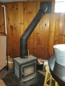

My friend has a stove that he had installed - all in he spent almost $6k. The stove is a Hearthstone (see pic - the same brand I own but have not yet used). He said that it is a nightmare to get a fire going. He has so much back-draft when trying to light a fire that it actually blows out the matches AND a lighter! He has resorted to using a hairdryer for 10 minutes or so to warm the chimney from inside the stove before he can even get a lighter or match to burn long enough to catch the paper on fire. Otherwise, if he doesn't do this, even if he's lucky enough to get it burning, it will fill the basement with smoke and will not draft.

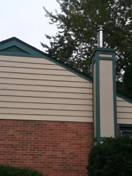

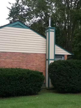

I think the chimney needs another 2-3 feet on top? It appears to be the "10 ft from nearest peak" but not high enough above the peak of the roof. Your thoughts please.... [Hearth.com] Very Poor Chimney Draw [Hearth.com] Very Poor Chimney Draw [Hearth.com] Very Poor Chimney Draw
This sounds like strong negative pressure in the basement. What was the outdoor temp at the time of testing? Have your friend on a cool day try opening a nearby window in the basement about an inch and see if the back draft issue is reduced. If that works then investigate to see if there are house issues that are exacerbating the problem. Things to look for would be a leaky attic door, or ceiling entry or ceiling vent. Open windows upstairs, exhaust fan running (bath, kitchen, dryer), can also cause issues with basement installs.

Do you think the exterior chimney is high enough?
Thanks.
Looks to me like he has 18-20' total chimney height, that should draft pretty well. It may not quite be high enough above the roof, and the surrounding trees may be screwing with things too.
