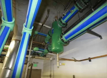

30 years from now it may all be composite pipe. Many progressive contractors are already doing 2" and larger with composite, melted together.
Did you wait 50 years to install ABS/ PVC and pex?
  • [Hearth.com] Viega Pro-Press
