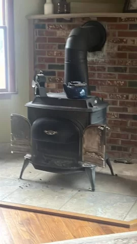

Vigilant 8Inch to 6in clay chimney
Dbredell
Jan 15, 2024
18
Newfield
I had the chimney cleaner out and he noticed a lot of soot in the chimney. The chimney is clay and he recommended a steel liner going inside of it. Only a 6 or maybe a 7 inch would fit into the chimney. Our vigilant is an 8 inch exhaust. They said I can buy a whole new fireplace which I don’t want to because a big reason we bought this house was for the stove. Or I can keep the stove and have to rebuild the chimney for like 5k.
Obviously the cheapest route would be to just adapt the 8Inch to the 6inch.
Any thoughts or recommendations ?

What are the current inside dimensions of the flue? Is it clay lined?
How tall is the chimney? You may be able to connect the stove to a 6" liner if tall enough, using a reducer. Doing so may mean it can't be used as a fireplace with the doors open. Or the clay liner may need to be busted out to increase room for an 8" liner. If the current chimney is rectangular, an oval liner may be the solution.

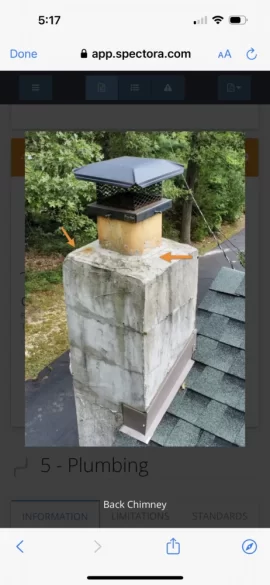

He said there was a little crack in the chimney which being clogged with soot.

The chimney is about 15 foot high. It’s 7.5 inches on the inside currently but it’s clay. He told me a 6 inch would fit in it but you can’t go from a 8Inch to 6inch. The exhaust is oval
Is the chimney interior or exterior? Is the clay liner square or rectangular?
Yeah the clay can definitely be removed allowing for 7" but probably not 8"
I'm wondering if this has a rectangular chimney liner like 7x11 ID. If so, an 8" equiv. oval liner may fit.
Yes that would work if it's a rectangle
