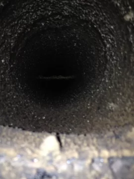

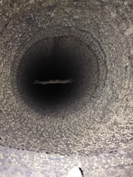

Thanks for all the input - sweep was postponed as the roof iced up and we haven't had good conditions since.
Meanwhile I used one of those Chimney Sweeping Logs and burn a hot hot fire every morning, keeping flue temp above 300F (magnetic thermometer) for at least 30 minutes. The CSL seems to have done what it claims, based on pics (attached) I took looking up the flue before and a few days after.
