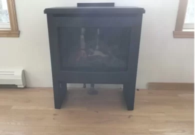

Visible propane pipe to new stove. Ugh.
AtTheBeach
Aug 28, 2019
8
Vermont
I picked a modern gas stove to replace a clunkier one without realizing the propane pipe would be visible underneath. DUH! Any suggestions for camouflaging this? I'm not even sure if we could run the pipe up inside the wall since it has a shut-off valve. Here's a hazy photo.
[Hearth.com] Visible propane pipe to new stove. Ugh.
Thanks. How could we have avoided this in the first place? All of the brochure pics (Valor Madrona Modern) show an empty area underneath. Should we have moved pipe up into wall?
Brochure pictures only show ideal situations. They call that marketing. I think the metal sheet (26 gauge will do) is the most simple solution, I think.

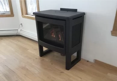

We're still mid-renovation. It's got the barrier screen on here. I really like how the stove looks.
  • [Hearth.com] Visible propane pipe to new stove. Ugh.
Honestly looks like a pretty neat installation
That’s normal. It has to have a drip leg for any debris to fall into. You can go directly through a wall with copper, but not run it inside the wall. That needs to be black iron.
I think any gas stove or freestanding fireplace looks stupid without a hearth pad and wall protector behind it. If it were a real stove it wouldn’t be sitting there like that and I add black pipe coming out of it going into the wall or to ceiling to make it look like a real wood burner.
Thanks for the pipe info - quite helpful. We're not too worried about it looking fake - it IS fake and there is no fooling anyone in Vermont. We'll have real wood crackling on the screened porch.
