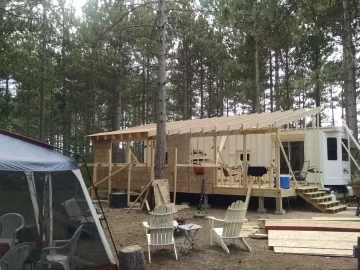

Looking for a stove for my new addition on the trailer / cabin. I have a 40' Crossroads Hampton and am in the process of stick building an addition on to the side. It will be a free standing , not attached wood structure. 14' x 35 long all open with a 3/12 lean to vaulted ceiling . It is butted to the trailer and will have the patio doors removed and the rear bedroom door open to have spaces as one.

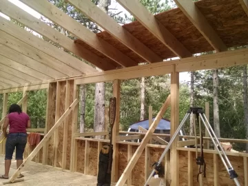

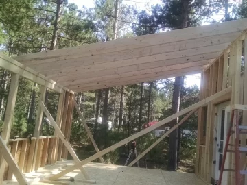

I have about 7'4" right at my outside bearing wall. I go up from there at a 3/12 pitch. I didnt check top of stove to ceiling clearance but I did see the R2 required hearth. I could move it to one end wall and replan my furniture layout if ceiling clearance is an issue. I plan on a couple sleeper sofas in the room and a big screen tv. If I move it to the gable end wall I can have about 21 more inches from top of stove to ceiling, putting me about 9' ceiling height. When you say flue , do you mean top of stove to ceiling or is flue same as chimney total ??
Ill try and post a pic .

I was planning on putting it in the 4ft space between the windows where my wife is sweeping. If the ceiling is too close with the thickened hearth of R2 , I could move it to the end wall about centere and gain a bit of height.
The 15' has been confusing as some show the 15 from floor to top of chimney and others show 15' from top of stove .
What do you think would be a better location ? Centered in the long wall where I have the 48" blank between 12 ft of windows on each side or on the end wall where you can see the laser in the back ground ? My trailer patio doors would be opposite end .
You will get better performance, particularly in milder weather with a little excess chimney height. The more chimney in the interior the better. That also reduces the amount of expensive chimney pipe. What about up against the mobile wall? is there room there?
Good idea , more single wall and less Class A , we will have to rethink our layout when we go up labor day weekend . Thanks for the ideas.
