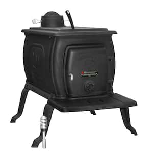

I dont say much about Vogelzang on here but Vogelzang takes a lot of flack based on the old fashioned stove thats still made by them meant to be a cheap old fashioned type stove that was used years ago. You get people trying to compare it a $100 stove to $3000 stoves.
They get a lot of flack for the EPA exempt stoves that are dangerous. US Stove also has a few stoves like this. And these are not "$100" stoves. They are listed for over $400 on Home Depot:
