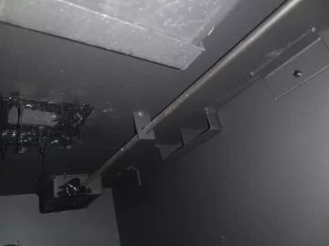

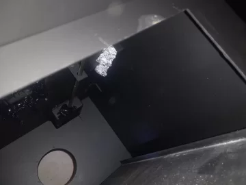

@begreen @bholler. Since you guys arguably help more people on here than anyone else I wanted yall to see this. So I found the reason why these stoves run so hot. It's 39 here right now so warm. Draft shouldn't be to strong. Had all air shutdown and 2 key dampers closed. And was still getting 800+ stt with flue surface temps of 400f 18" above flue. This had been after a very slow and gentle startup. Shut air and dampers down way early less than 200f flue surface temps. So I started testing with an incense to see where it was getting all this air. Pulled ash pan and smoke got sucked into huge air inlets that are unregulated. 2 on each side. Each one is about 2" by1". So that's 8sq inches of uncontrollable air. On top of 2 big controllable air slots. Plugged them with tin foil and within 2 min temps dropped a huge amount and Flames became lazy. Just thought it would be good info for people who buy one of these

Isn't that your secondary air inlet(s)? Those generally are unregulated on most stoves...if that's what they are, then you don't want to totally block them off...
I don't know what they are but. The stove is damn near uncontrollable with them unblocked. I smoke checked everywhere on the stove and could find no leaks. But these sucked up the smoke like crazy. Like I said it's warm tonight I shut both air controls and both dampers down way early in the burn and fire started slow. Then all of a sudden after air and dampers had been closed for 20min at this point. It starts taking off. Stt of 800+ and flue surface temps of 400+ in my opinion not safe for everything having been shutdown for 20min. I blocked those intakes and right now have stt of 640 and flue surface of 280. Secondaries still burning. Opened up 1 of the key dampers
They probably are secondary inlets just pay attention and make sure you still have good secondaries. I have a feeling ussco simply added more air to meet 2020 regardless instead of putting money into actual engineering.

If both recently sealed openings are indeed the secondary supply.........
Why are you continuing to experience such vigorous secondary burn _g
May need more foil and goop somewhere!

Yes out shuts them down. I have checked controls probably 30 times now lol. Those ports I shut off are the secondary ports but it's uncontrollable with them open. I've checked for air leaks all over tge stove and have not been able to find any
