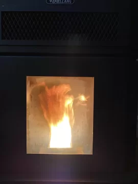

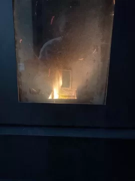

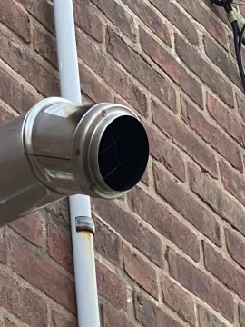

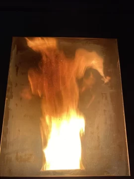

Hello everyone, I’m very new to the pellet stove life. I’m having an issue with the VG5790. It starts up fine and gets a pretty big flame but not long after startup the flame starts to die down. The flame will Fluctuate for a time and then inevitably it will just go out. I get a lot of soot all over the glass after only running for maybe 2hrs. We did install the outside air intake, hoping that would help but didn’t make a difference! Please help I’m new and have no idea what to do!

Has this stove run well before, or is it a new installation? If it’s a new install, is the stove new or used? Is the pipe clean and free? I always ask because I’ve had birds get in my pipe on the past. If the stove is only a few days old then it’s clean but if it’s a used stove then it should have a total cleaning including the side chambers and the exhaust blower housing.
I’ve had pellets that clogged the burnpot every day or two and I had to constantly clean it. Hardwood pellets are good with this stove as I’ve heard from others as well. But pellets do vary. I would scrape out the pot and try again.
Have you tried adjusting the air damper in back?

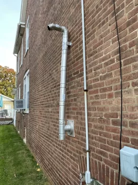

I see a couple things. One, that isn't soot on the view glass, that is burned fly ash and they all do that, pay no attention to the 'air wash' propaganda because that is what it is, BS. Secondly, you need to loose that open end at the top of the venting, no good and inviting trouble from birds getting in. You need a 90 degree vent elbow and a proper termination vent cap. What you have now looks like the tailpipe on my diesel pickup truck.... :eek: Furthermore, you have no incline on the vent pipe between the stove and the wall thimble but you are stuck with that as it's already installed in the brick
That is a proper termination end it has a screen grid inside the end. But If the wall is on the prevailing wind side of the house it could mess with the airflow/draft. Like Tlc was saying try adjusting your intake damper to get the flame right.

It’s a brand new stove and installation we did ourself. The manual never said anything about and incline ( wish I would have know that) would the incline affect the flame? The stove has never really ran good it does give off heat but never had a good flame. Based on the photos ssyko shared we have had both the bottom images but never found that sweet spot to get the perfect flame. We have adjust the damper in every which way we could. We are thinking of just returning stove but still at a loss for what to get we can’t afford anything outlandish

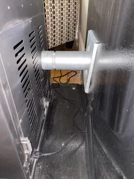

How did you install the outside air kit? It’s an additional tube through the wall and needs to be attached to the pipe near the bottom center of the stove directly below the air damper. And run directly through the wall to the outside. In the photo I see nothing attached to that pipe below the damper. That’s the stove air intake.
I tried my stove without outside air and it would start ok but the damper had no effect on increasing the flame, and after awhile it would just choke and die. Night and day difference with outside air installed. My house was 30 years old and I figured it was old enough to not need it but I was proved wrong.
Btw I have nearly the identical chimney setup. I have an open end which came with the duravent kit except it’s rectangular and I have a 45 section in the house. I also have the extra height outside like you, which I think would make up enough updraft for whether or not there is a degree or two in the slope of the short horizontal section.
I haven’t had a bird in this particular pipe but I’ve had them in my old wood stove pipe, dryer vent, and my brick chimney here. A bird screen would be something to add before the day they decide to come in.

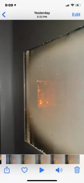

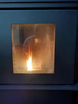

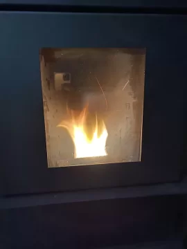

We tightened the laches on the door and now this is the flame we have. Is this too big ( first 2 imgs) then it goes down to the 3rd pic way better then what we had!!

A big flame is normal when first started. Looks much better in the 3rd pic. Does it stay that way? A little up and down is normal

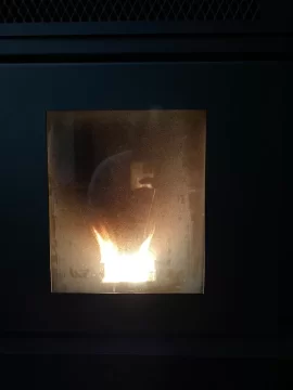

It has been doing great so far! When I turned it to low the flame went out but I turned the damper down a little and it came back. It still goes up and down but isn’t going out or staying low for long anymore. I tried to post a video for you to see but it won’t let me the pics show the different “levels” of flame we are getting. cycles up and down takes about 30 second to a minute

Try closing the damper 1/4” at a time and let it run for 10 each time. You’ll have it dialed in in no time. Its looking better all the time
Yes you’ll have to find the sweet spot for each heat setting but once you get used to it, it’s easy. You could use different colored sharpies and mark the damper rod for each setting when found. As for start up ck your manual for its start up settings.

This is the flame I am getting now after closing the damper a little more I hope it’s okay if I keep posting the videos just so I get your opinion on what a good flame loos like for this stove
Looks good. As you play with the rod settings just watch your flame, when it gets lazy open it up a bit and that should be the sweet spot
