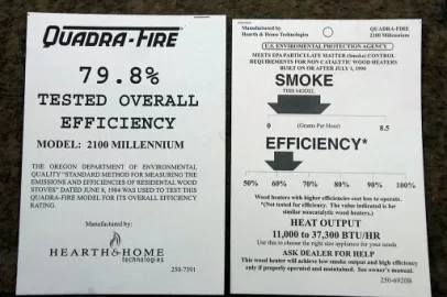

I can't answer your question, but here's an example. These are the data sheets that came with the Quad 2100M.
Frankly, I don't believe the EPA numbers.
Smoke of 2.1 gms/hr. But the Morso 2110 at 4.5 gms has less visible smoke out the chimney over the whole burn cycle.
We already know the assigned 63% efficiency number is meaningless.
Heat output rate range of 11k - 37.3k btus/hr. I defy anyone to get this stove to burn as low as 11k btus/hr cleanly. This stove wants to burn hot. And 37.3k tops? I say that's low. They tested the Morso 2110 at 42k btus/hr max and I know the Quad stomps it.
So these EPA numbers are suspicious at best and useless at worse.
BUT... the overall efficiency number on the cert that Quad furnished with the stove corroborates my experience with it. For wood input -> heat output, this thing is sick. (That's what my son sez when something is unbelieveably good.) Compared to the Morso, which is about the same size and I considered to be no slouch, the 2100M keeps my house warmer and uses less wood doing it. Period. Judging by the amount of wood needed to keep my inside woodbox full, I'd estimate the Quad is about 20% more efficient overall. That's a significant amount. Needless to say, I look forward to having it back on the hearth next winter!
But.. the point of all this is... the EPA numbers don't tell us what we need to know.
Is anyone familiar with the "Oregon Standard Efficiency Methods" from 1984 that Quad is quoting?
