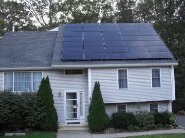

    Well, our solar array is up. It is ready to go. However it has to be inspected by the town electrical inspector, then the utility company before we can go live. So of course all this week we have had clear sunny weather. ARG! now to be fair I knew we probably have 3-4 weeks left before we go live, but it is SO annoying! Ug.
    Anyway, this array is sized to provide for our full electrical needs (+/- 10%) on an annual average basis. Grid tied so no batteries etc. We've reduced our electrical use quite a bit over the last few years through conservation so hopefully we'll keep it down, but with the kids growing up I'm hoping that our actual performance of the array will be on the + side of that so we have wiggle room to grow. Not to mention it should help speed up the payback time....
    With all incentives/rebates/OPM and anticipated SREC revenue (using the MA mandated minimum values) we should see a payback within 7 years so the finances were acceptable to us. It looks pretty good in my opinion too :)

    who did your install, I am having shw install in about a month, looks good

    I went with a local company called SolarFlair. They have done well so far. Nice clean work inside and out. I can't judge the results yet - will have to give it a year or two before I can tell on that. Their stated warranty beat out what others were offering and the rest of the package was quite competitive and the company has been in business for long enough to give at least some track record to look at. (It doesn't hurt that I met the owner a number of years ago prior to my seriously looking into this project).
    As I went through the process of selecting who would do the work I was surprised at how many companies are now serving this market. It seems that it must not require a whole lot of expertise to claim to be a solar installer or reseller. Even as late as when I was getting estimates on my roof (we ended up deciding to re-roof under where the panels were going so we wouldn't have to do it later requiring removal and re-installation of the panels) one of the companies I talked to did roofs, siding, gutters, windows, and you guessed it - solar installs.
    I'm sure the MA SREC system and the overall rebate system combined with the recent dip in costs has made the market attractive for many more people - thus bringing in a slew of folks wanting to jump into the business of providing for this demand to install. I'm sure not all the new entrants to this business are bad, and in fact some may well turn out to be the best in a few years but sorting them out right now is likely to be a challenge.

    Wow, that is nice. Congratulations. What is the output? Looks like about 7KW?

    35x190w gives us about 6.6kw DC rating. Of course only time will tell what it actually gives us. We have a bit of shading on the sides that I'd like to convert into stove fuel but I haven't convinced the wife that it is worth giving up the landscaping... yet.
    The shading puts us at about 83% solar access which is fine for the utility co who actually doesn't want us to exceed our current annual consumption estimates (funny that eh?). I figure that after a year I can take down the shading on one side or the other to boost production by a few %'s for far less than adding panels.

    What brand of panels and inverter?
    I liked the NH approach with mine. Once it was ready, the utility allowed me to "test it" while the paperwork got completed. ( I have a two way meter)

    Suntech panels with Solectria inverters.
    We don't have the two way meter yet so I suppose that may be part of the delay. In any case, the system is literally locked up (big red clamps with locks) until the town inspector gets here... perhaps they know the temptation is too great for folks like me to 'just give it a try" they they don't.
    This project has been in process for quite a long time - we made the commitment back in May so it has been a long wait already. Somehow though it is harder when I see the panels every time I come home. Of course it doesn't help that we made a payment when the panels went up as well. Murphy's law says that once we get the final clearance and turn it all on we'll have a record period of rain, clouds, and "Irish" weather too I bet. At least we'll be ready for next summer's production season.

    I was wondering how much those panels weigh?. I would think that on a less well built home it may be to much weight.

    Looks great. With a 7 year payback, you must have a smile on your face every time you pull into the driveway and see it. I wish the ROI in NY was that good.

    re: weight - I'm sure it is a factor for some folks, I am fortunate that our home is relatively new so it didn't take much of a formal review to determine that our roof was strong enough. Besides weight one has to consider wind getting under the panels and lifting, thus the rails are bolted directly into the rafters - not something I had considered at first but makes sense once you think about it.
    re: payback - Indeed I will be smiling once they are online! Right now it is a bit of a tease, but I know - think longer term.... however it will be more "real" once I actually see the numbers working in my favor on the utility meter and bill. I just received a monthly bill and it was the usual amount despite having the panels up for a couple weeks since we are still waiting on the utility co to put their meter on and give the ok to turn the system on. I'm sure it will be before Thanksgiving :)
