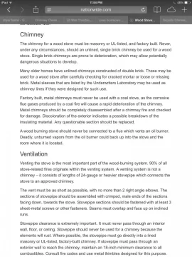

Hi I'm new to this site and have some questions. I'm a 29 year old female that just bought a large brick house built in 1817 with 4 large chimneys, one on each corner. Prior to me buying the house one of the 4 fireplaces was removed and bricked over and so was the wall thimble above it that goes into the same chimney. I recently broke out the old thimble hole, put in a new thimble, and cemented it in place with Rutlands fire brick mortar. The wall around the the thimble is plaster but it's about 1/2" thick and it's directly on top of the brick without any lathe or wood. Would this be considered a combustible wall? How far clearance from this wall does the chimney pipe have to be. It does have wallpaper over the plaster. I am also using a antique sears and Roebuck potbelly stove, it's very small and I plan to burn coal. What should I use for clearance guidelines with this stove? I looked online but couldn't find anything specific. Thank for any help!

I am much more concerned about the size and condition of the flue

If there's no liner in it, then it's not a safe chimney to burn in. What are the interior dimensions? Time to look at a stainless steel liner.

NFPA 211 guidelines from '03 say:
7.2.2.1 Masonry chimneys shall be lined.
Thus website says if your chimney us 2 bricks thick and that if the joints are staggered you don't need a liner. Is this not correct anymore?
http://inspectapedia.com/chimneys/Un-Lined_Chimney_Flues.htm
From that page I also saw residential building code requiring lining. This is a must. Lining will not only improve stove performance, it is a major safety improvement as well. A wood stove can and will get the flue very hot. Brick, even double brick, will transmit that heat to surrounding combustibles. And brick mortar will degrade over time, increasing risk. A proper insulated liner eliminates the worry and risk. This is really important if and when something goes wrong, and it will. For example, we get regular reports here of folks forgetting to close down the air on the stove. The flue in this case may see a sustained high temp of 1200F or higher for an hour or more. Yes, a liner is an additional expense, but consider it an investment. When something goes wrong, as it most likely will at some time, you will be thanking yourself for making this investment.
Note, the chimney must be thoroughly cleaned before lining. If you hire a certified sweep that person is qualified to do the lining. For a list of certified sweeps in your area enter your zip code in one of these sites:
www.csia.org
www.ncsg.org
To answer the wall thimble question, there is supposed to be brick 12" all around the thimble as it passes through the wall unless there is a special shielding thimble. This article covers the topic: https://www.hearth.com/econtent/index.php/articles/passing_a_chimney
