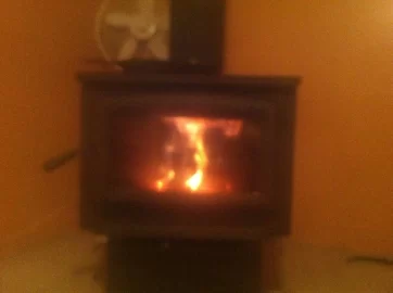

Got it installed today. Had our first break in fire at350* already got secondaries pics are with it am pretty happy just waiting for it to get back to room temp and go at it again. Need to order a probe therm from condar tommorrow got the flue up to 250 on outside of dbl wall pipe thinking 600 inside temp maybe but very glad I got this unit
Awesome fire. Any bad odor?
Slight not real bad, smelled like the dbl wall when it was first fired that stove holds and puts out heat for sure.

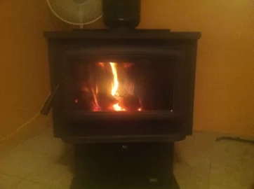

Here's a pic if the second fire it now just simmering with a little flame and some secondaries.
Note that the fan should be considered a combustible and clearances to it honored.
Rite on begreen, there's a good 18" between it and the stove. I'm on burn 3 now maybe should start another thread? Stove is breaking in nicely just takes awhile to warm up. Added 2ft of flue helped out a lot and a roof guy kit and I caulked around all the screws too

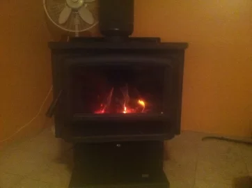

Opened the air up slightly after this pic, not sure if it should be or owners manual is a little vague but got nice secondaries and wood is coaling well

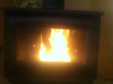

Put a small load in after work and going to put an all nighter on shortly . Stove top is at 250* is this going to hurt anything ?
250? It might hurt your hand if you hold it too long on the stove.
This is too cool although I think the flue is getting upto 800-900 got it half way down
[Hearth.com] Want to cover my bases
Party pooper
Safety snooper. A nearby combustible fire can turn a joy into a nightmare. Clearances need to be heeded. Sounds like he has it covered and 18" away.
