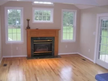

We attached a picture of the current gas fireplace. Will a woodstove require a footer/support in the crawl space under the room in order to support it? Also, since the sunroom's roofline is well below that of the main house, will the chimney have to be extended really high to avoid any down draft issues? What kind of cost estimate could you give for a wood stove with the chimney you mentioned?

from you picture you would have to loose both middle windows for a chimney to pass outside. You also need a substantial footing and the bump out you have is not framed or setup to support the weight of a brick chimney that would have to be removed there will be quite a bit of framing also involved
what you have is a direct vent gas fireplace setup only for that purpose a brick chimney and fireplace would be a major prodject

I wonder that stainless steel chimney would look like threw those windows it would pass by
If it stayed inside it could be black double wall straight up through the roof and draft better then going outside.

I probably wouldn't go through the wall at all. Instead I'd replace the gas unit with wall, extend the size of the existing hearth (maybe make it raised) and build a rear wall NFPA clearance reduction style where the gas unit was, and use a top vent wood stove w/ the pipe going straight up to a roof passthrough to the Class A.
It would look better from the outside, and I think could be done up real nice on the inside w/ either a brick facing or fake stone.

Goose how would deal this the top of the stove clearance issues placing the stove in the bump out. Many stoves require up to 5' above the stove for clearances
No bump out. tear out the gas stove and bump out frame up the wall and build a hearth in the room.

Exactly... I suspect there isn't much (if any) bumpout right now, and I don't see a big advantage to adding one in view of the way it would move the pipe outside, mess with the windows above the stove, and so forth...
One could possibly do a bumpout and an alcove install, but that would be trickier, a bunch more work and expense, and I don't think it would offer enough advantages to be worthwhile.
