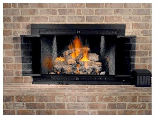

This one is the Stoll Grate Heater
[Hearth.com] Want to take the edge off when burning my fireplace, heatradiator or stoll grate heater?
This one is the fireplaceradiator.com unit.
Just wondering if anyone has had experience with these and if they are even worth my time. I'm not expecting any kind of high output, but it would make me feel like I was at least putting some heat back into the house. 500 bucks is not going to break me, but if it's really just not worth it, then I'd rather just dump it into the oil tank as much as I hate doing that.
Any comments about the two options would be greatly appreciated. I know Stoll is a pretty good company but their product is slightly more expensive and it seems like they are getting their heat from almost underneath the fire where as the other product at least has a fireback type thing that would capture more of the heat. Comments welcome.
Thanks,
Roveer

I may not have been clear in my initial post. Both of these units are designed to sit underneath a set of glass doors (which I already have). I believe you then burn with the door closed.
Maybe someone with more knowledge can correct me if I have made a mistake in my assumption.

I may be mistaken but I don't see how one of these units could sit under the existing glass door if the glass door already closes tight to the bottom channel of the fireplace opening. I think you need to buy their door to fit this unit.
I've emailed fpr and found this on Stoll's site:
"Brand New! from Stoll, the Grate Heater captures heat from your wood-burning fireplace. The new slim profile allows you to increase the efficiency of your fireplace while keeping your existing door."
FPR replied to my email with the following:
"Yes, that style of door does work with the Fireplace Radiator, however you would need to remove your doors and adjust them up 1 1/8" to sit on top of the front diverter bar of the Fireplace Radiator. Most doors have room for this adjustment but not all. It depends on your fireplace opening height and how the doors mount in your fireplace."
Your just pushing the door up a 1 1/8". Existing door still sits against the FP opening just a little higher. Now you will need to be able to move it up either by having additional space or possibly cutting the brick a little higher. If you had a steel lintel at the top that would probably be a deal breaker. I don't believe that is the case in my FP though.
