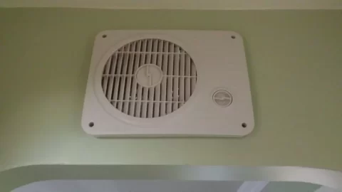

Depending on the floor plan and stove location, I've seen these types of fans installed, and owner feedback seemed positive.
(broken link removed to http://www.hvacsolutionsdirect.com/products/Wood-Stove-Products/Room-to-Room-Heat-Transfer-fans/Suncourt-TW208P-THRUWALL-ROOM-TO-ROOM-Air-Transfer-Fan-SKU43.html)
These work well for me mounted above doorways
This is great.. I wish I could find something similar for ceiling/floor application
