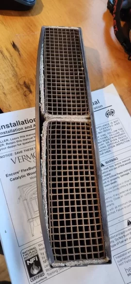

I purchased 2 replacement catalysts from Condar, one to have as a backup, for my VC Flexburn Encore. After only a month of use, I noticed that the steel frame of the catalyst was warped (see picture). I replaced it this past weekend with my backup. After 2 days of use, I checked on it this morning, and this one is also warped. I'm burning oak with a 14 - 18% moisture content. I don't believe I'm letting the cat get too hot. The original cat lasted 4+ years and I only replaced it because some of the cell walls were falling out/thermal shock. I attribute this to a friend who was staying here that tried to be "helpful" by loading my wood stove one day without disengaging the cat, leaving the doors open, tossing in cold wood.
Anyone else have this problem? Are they defective? I unfortunately bought the $129 model "with no warranty" because the others were sold out. It's hard to find this cat given it's the 1" model.

The only thing I'm doing different is that I'm trying to get a longer burn by taking the primary air as low as 20%. I've never been able to get more than 4 hours out of a load of wood and am jealous of the posts I've seen of others who can run at 20%. So, I found a few great resources that indicate that once the stove gets to temp (550°), I can engage the cat. Leave the primary air on High for no more than 30 minutes (I barely go 15), then adjust the primary downward when the indicator is in the Operate range at the back of the stove. They said that once the cat is operating, it will keep itself hot enough to keep going, even though the main temp will fall. I wouldn't think that could have caused the warping of the frame unless I unwittingly let it overheat, but it never gets above the "A" on Operate (sad - I wish it was a true thermometer).
I have a love/hate thing going on with this stove. She's fickle. I just wondered if it was a quality issue with the steel framing on the cat. I've seen other cats with a metal cross member that is wrapped around the cat, like a belt around your waist. It would seem that would hold it together.

yea thats exactly what someone did in the vc thread, they put stainless bands around it because their cat was warping too. Then they ordered a steel cat thinking that might help but have not received it yet.

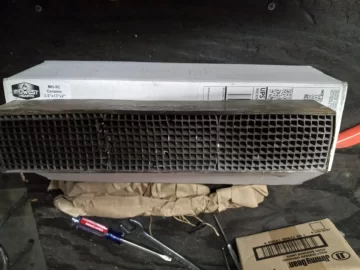

Might have something to do with it being a 1" thick cat, mine is 2". A true temperature probe will tell you cat temps and they will see 1500-1600 pretty often so I'd say that's what makes that thin stainless warp. This is a pic of my old cat, probably 6-7 years old at least, lost track probably older than that.

I was wondering if I could substitute the 2" high cat for my 1". Seems the 1" is for the flex burn. Are you substituting or did this come with a 2"? I can only find a metal 1 " now. I'm using one of the warped cats for now.
My stove is a 0028 Encore and that's the factory size. Mine has a panel on the back held by 4 bolts that you remove to install the cat.
