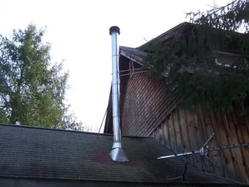

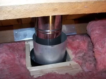

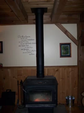

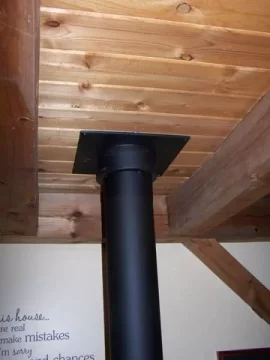

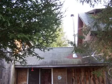

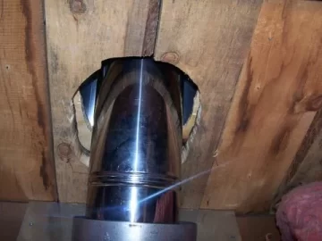

Everything from the stove up replaced with the exception of 2-3 sections of the single wall outside stuff and the cap I think. I was feeling like it was all replaced, but it was just rebuilt and stuff was added. Everything inside was replaced from the stove up. We hired some one to come and clean it this fall, and when he got here he started cleaning it and then discovered several things about the whole install that was wrong, and he stopped at the point and said don't use this, this is all wrong. So then the whole thing was redone, and they did use a few of the same pieces as they were fine. The chimney had to be higher and inside some clearances were not right.
The stove was put in end of February of this year. Hopefully you were able to check out the photos on the other thread. Well actually here, I can just repost them!
[Hearth.com] Was hating my F3100, had first stages of a chimney fire last night
