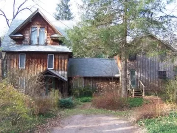

Ok, this is our house. So you can easily see how the living room is in the middle (which is where the stove is, pipe is on the back) and then the two sides going up from there. Just doing one right now to see if this is how I want to do photos, or if I want to try the URL thing!

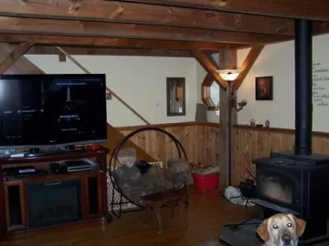

Very cool house! Er, I mean "nice".

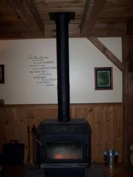

Here is the stove.

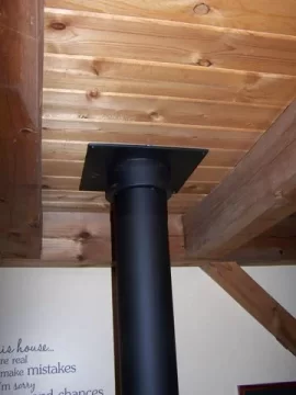

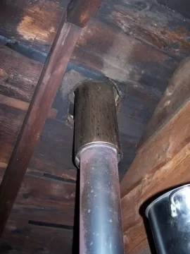

Going into the ceiling, they originally had single wall there!

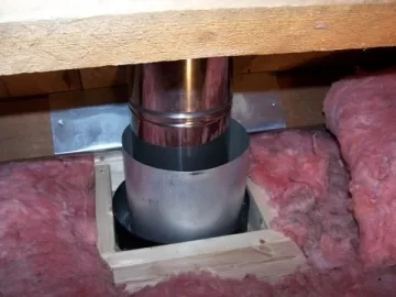

Coming out of the ceiling into our attic.

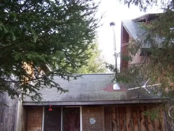

Going out of the attic.

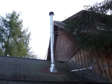

The rest outside.

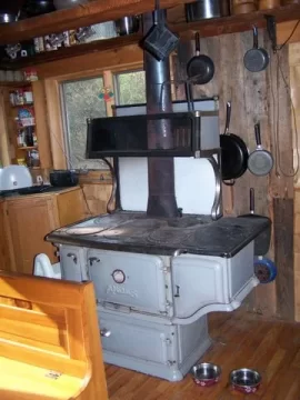

Here is the other stove.

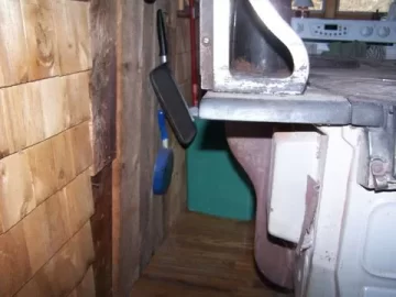

This is the back from one end, where we were told it is too close to that wall.
[Hearth.com] Help me not hate my Regency F3100.
Same thing, just other end.

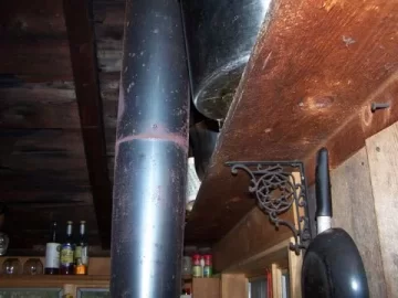

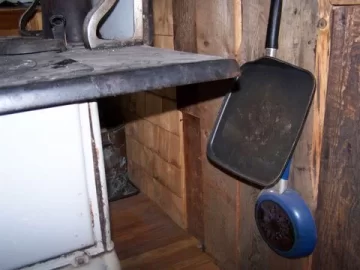

And here is where the pipe is very close to the shelf. That pot looks like it is touching but it is in front of it, closer to me taking the photo I mean.

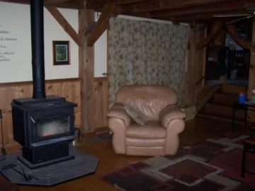

This is in the living room, so you can see the stairs going up there to the left of the stove on this end, that's the 3 story side.

This is the other end of the room, with the other set of stairs going up into the other part.

Thanks for posting the pictures. They really help. That's a nice house. I'm surprised to see you are in the Syracuse area. I would have guessed the northwest with that handmade craftsman style.
The livingroom looks like an enclosed breezeway connecting two separate dwellings. That explains why the kitchen side stays warm and the heating challenge. The next step will be figuring out how to get the heat into the main house. Is there a doorway to the first floor from the living room?
Do you have a 12" table fan or a basic box fan? Would it be possible to post a rough sketch of the first floor plan?
Also, you mentioned some safety concerns about the kitchen wood stove. What are they?
Just looked at the kitchen pictures. That's a great looking cook stove. There definitely is a safety issue with the flue pipe. Unshielded single-wall pipe needs to be 18" from combustibles in all directions.
So since we can't move the stove, or the pipe, what can we do? The shelf could come down, but that wouldn't give us enough inches still I am thinking. Can we put something protective on the shelf? Like a shield? Or like if we take down the shelf and tile that wall?
Open to any ideas!
Open to any ideas!
Replacing the existing single wall pipe with double wall pipe should solve the issue with the pipe clearances.
Open to any ideas!

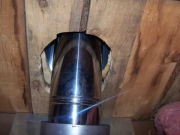

The first question is how the pipe is exiting the room? Is there a proper support box or an illegal setup like you had in the living room? If it is a legal support box that transitions to class A pipe outside, then changing the interior pipe to double-wall connector and increasing the shelf clearance may be enough. The shelf could have a wide circle cut in it with a jigsaw to make the 6" double-wall clearance requirement. It looks like it would need to be about a 3" deep cut.
You could also attach a pipe shield to the single-wall. That would also reduce the required clearance to 6".
Here we go, just grabbed a picture of the top!
Are there things illegal about the living room set up right now? As it's shown in the pictures I posted earlier? Or do you mean how I'd described how they'd had it with the single wall before they fixed it?
