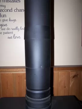

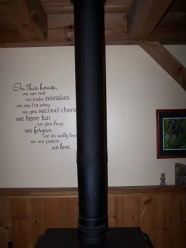

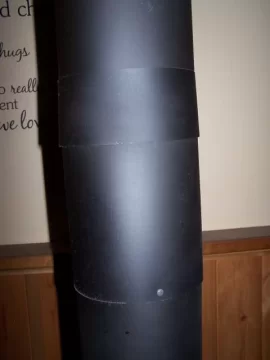

I have one. This wood is dry. But I did burn for probably two weeks prior to this wood, with wood that was not as good.
I trust BG's and Bob's eyes.
Okay - so insulated - it is as good as that part of the system is gonna get.
Now we are back to the rest of the system and practices. You got a moisture meter?? Or know anybody that does? Or are willing to spend 20 bucks on one??
![[Hearth.com] Was hating my F3100, had first stages of a chimney fire last night [Hearth.com] Was hating my F3100, had first stages of a chimney fire last night](https://www.hearth.com/talk/data/attachments/84/84790-e10ca2862327a4fad3798f0ca2d13b7e.jpg?hash=0KdV07ZSBB)
![[Hearth.com] Was hating my F3100, had first stages of a chimney fire last night [Hearth.com] Was hating my F3100, had first stages of a chimney fire last night](https://www.hearth.com/talk/data/attachments/84/84791-57d18f522e2568dc3f34e28cf6b712e3.jpg?hash=MEYSXn4fXb)
![[Hearth.com] Was hating my F3100, had first stages of a chimney fire last night [Hearth.com] Was hating my F3100, had first stages of a chimney fire last night](https://www.hearth.com/talk/data/attachments/84/84792-058956b045941cc1e8bb90237ff4b8c7.jpg?hash=GpsbnjzoB2)
![[Hearth.com] Was hating my F3100, had first stages of a chimney fire last night [Hearth.com] Was hating my F3100, had first stages of a chimney fire last night](https://www.hearth.com/talk/data/attachments/84/84793-afd1a05fc15e73d6ef055619925c7376.jpg?hash=sSafW_MFHs)

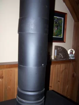

. Others can advise on whether or not that suggestion was overkill, but from what I read the whole setup and history etc. kinda makes me nervous. Good luck with everything.![[Hearth.com] Was hating my F3100, had first stages of a chimney fire last night [Hearth.com] Was hating my F3100, had first stages of a chimney fire last night](https://www.hearth.com/talk/data/attachments/84/84844-cbb2a7ddf87a052b335941173416ebec.jpg?hash=b7mDpKButy)
