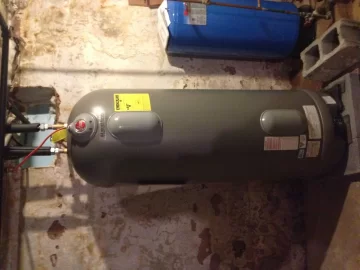

Nope. Probably just set a reminder in my phone to turn the furnace on once a month and let her run for a little. I will set my Nest to give the boiler an exercise over the winter though. And a pic was requested, so here it is! Don't mind the horsehair plaster. :)
