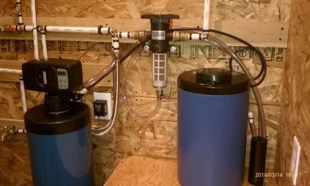

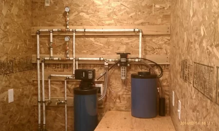

Clark, I just got done installing an iron filter that I bought from cleanwaterstore.com. It is a fleck based system that includes a side tank and has all of the same brine, regen, backwash cycles as a salt based softener. I love the quality of the components, the tech support, the price, and the service from the company. I would certainly recommend a non-hardware store solution when treating your water. The additional cost is small and there is a 6 month money back guarantee if the system doesn't work. THe tech guys will take your test report and recommend a system.
Here'a photo of the one I just installed. A little overboard with raw and treated gauges and hosebibs but it was easy. Oh and I also put in a 60 mesh grit filter ahead of the iron filter.
Give them a look at their website, you'll be doing some reading for sure.
