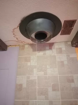

Hi all. I have a Waterford 104 great smaller stove. We are renovating and need to remove the ceiling collar. I have looked for any screws to remove but there isn't any.
Any suggestions on how to remove the ceiling collar assembly?
One thing to note, the stove pipe runs 15' vertical . Thanks

Usually the round trim ring pops off, then you should be able to see how it’s secured to the ceiling (probably nailed or screwed to joists).
No luck! Been struggling with this collar.
It's seems to peneatrate through the ceiling.
Does anyone know of a manufacturer it might be?
It looks pretty old. Is this in Canada? If so, maybe try an older WETT certified sweep/installer that has been around for a while. There are some sold in Canada, but not the states. It may be a discontinued product or a less common brand like Nordyne/Miller.
Is the ceiling being replaced or repaired in that area? If so, the easiest approach may be bottom up once the ceiling is removed in that area.
