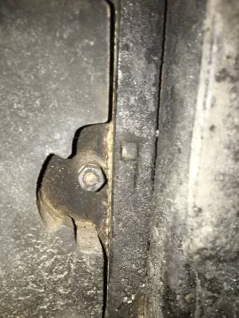

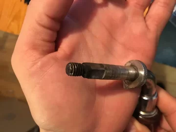

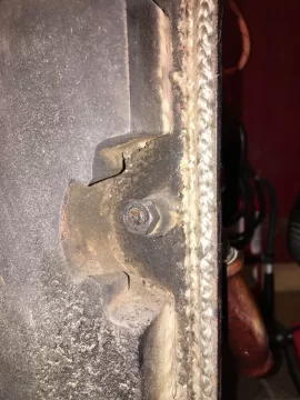

Hey all! I have a basic question but it's driving me nuts. I moved into a house that has a 1996 Waterford Trinity Mk II, but the side fuelling door is missing the latch to hold it shut. Unfortunately I'm a complete noob with woodstoves so I don't even know what the piece I'm missing would look like, and can't really tell based on the manual. Can someone with one of these stoves (or a similar model) help me identify what piece I'd be missing? I've heard from my local supplier that they no longer manufacture parts for this stove, but it seems like such a simple part that there has to be something on
Woodsman Parts Plus. You can see the handle has a square fitting.

It looks like it had a tension pin that slipped in the door latch. On the Erin this was part V00055AXX. Not sure about the Trinity. I would call both Woodmans and Obidiah's and speak with their repair guys. They may have something kicking around the shop that will work. You may need a new door handle too as the thread looks like it may have snapped off.
