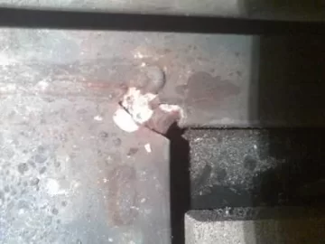

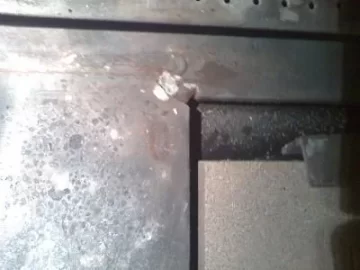

He put his nose to the stovetop and said WOW, that is some strange oily smell...I said yep, been like this for over a year. He also said I had 2 cracks inside the stove, right in the back in between the back firebricks...He said that should be covered under warranty (should be, it better be, in my mind). The guy took pictures and is speaking to the boss at Country Side Stoves in Holland, NY.

Here are some pics of the 2 cracks, not the best with a cell phone

As you say, the pics are not really clear but the cracks you are talking about appear to be in the air chambers which feed air into the secondary burn tubes.
Is that the case?

dust burning makes an aldehyde smell, but should go away after a while... the cracks you have inside are part of the inner air mainifolds, should not affect an odor of any kind.. strange.
I really never figured out what the smell was, a welder funded by Travis Industries ;-) came last month and welded the small cracks. I sold the stove last week for a great price and now I am getting a Lopi Berkshire (as noted in my signature). Travis Industries proved themselves to me and so did a local Lopi/Avalon dealer. This is why I will be supporting Travis Industries again with this Lopi Berkshire Freestanding Gas Stove
