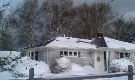

Could be the chimney location relative to the current winds. Got a picture showing the house and roof with chimney?

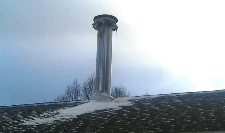

My chimney cap is there, not blocked but does have some ice hanging from it. First time I have seen ice on it. It that normal given my temps?

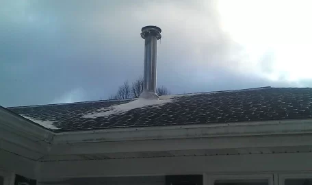

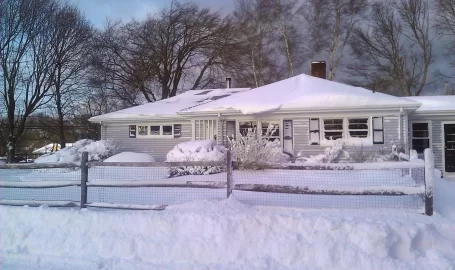

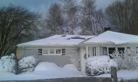

Let's try again, here are some photos of the metal chimney...

OK, nothing showing there that would impede draft. Last year about this time our cap screen plugged up. It had similar symptoms. It "seemed" fine when viewed from the ground. I would pull the cap as soon as is reasonably possible and check the chimney pipe up top too.
