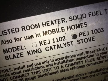

didnt know they made a princess with an 8 inch flue.
Yes, 8", circa 1990.
