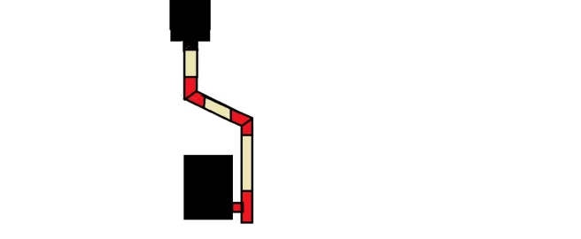

i clean the stove thoroughly in december pull all motor, plates, new vent pipe and replace all gasket etc..weekly i do a thorough clean except pull motors....i have attacted a pic i created to better explain the setup... i have two 45 degree and one t with clean out....from tee to first elbow i have a 3 ft pipe, from first elbow to second elbow i have 1ft pipe, from second elbow to chimney i have another 1ft pipe... [Hearth.com] wet chimney
You said it is 6" pipe so based on that EVL should not be an issue. I know you said you clean everything real well but one place I would check again is that cap. Make sure it is not blocked. So if the venting is all clean with no obstructions, check your OAK and make sure that is not blocked. Check your Air swtich and make sure the tube is clear. If you have a door adjustment for the door gasket make sure it is set correctly (dollar bill test) and check the other gasket locations to make sure they are all seated as they should be. If no luck with any of those, I would set everything back to factory specs and try adjustment from there. Also look at page 23 of your manual which talks about lazy flame issues. It still sounds to me like an air flow issue.
