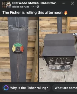

What’s the point of people getting their flue temperature this high
Itslay90
Dec 16, 2022
706
Upstate,NY
Why do people think this is good to do ? All your heat is going up the chimney.
  • [Hearth.com] What’s the point of people getting their flue temperature  this high
If he doesn't keep it really hot, the liquid creosote will make a mess of that upside down stack.
And who puts the seam in the front?
The old thermometers like this had a screw hole to attach it so that when the magnet lost its pull the meter would stay on the pipe.
Yes many do have a screw hole that type does not.
He’s probably got a chimney fire rolling with that old smoke dragon and don’t even know it.
Forget the temperature, the pipe condition alone is something to be concerned about... holy moly.
meh, nothing a bit of duct tape can't resolve - oh wait, that is what they had tried before. I guess that burned off right before they took this hot pic :ZZZ
Notice the stove has been freshly repainted. It could have been a solid white before that can of rattle black.
