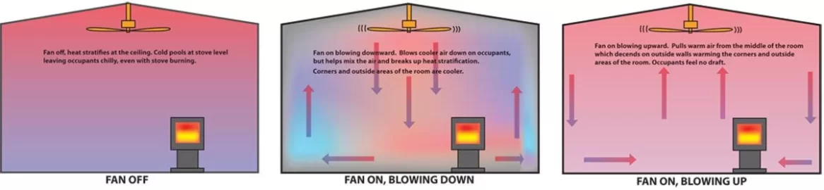

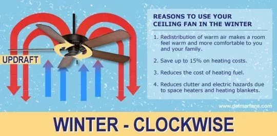

So which way do you have the ceiling fan set?? Blowing down, or pulling up????
Why is it not better to push the hot air down that rises to the ceiling in the winter?
[Hearth.com] What a difference...
Image courtesy of the wonderful folks at Del Mar Fans & Lighting
http://www.delmarfans.com/educate/basics/what-is-the-proper-ceiling-fan-direction/
Can cause a direct draft onto you and that could make you feel cooler.
Different directions work differently for different set ups. Some folks like it better blowing down, but most pull air up in the center which sends the heated air down the walls.

Been preaching this for several years.
An exception might be if it is a big room with a pair of ceiling fans. You can try setting one to blow upward and one down. The upward fan should be over the main seating area to avoid drafts. The two fans will create a convective loop this way, circulating the hot air trapped up at the ceiling peak.
Absolutely, this is the complaint I get from kids and wife every time I turn the fan on. Tried blowing both up and down, everybody except me wants it off so I am outnumbered. :mad:
This is my setup in the upper 1500 sq ft of our 3000 sq ft home....cathedral ceiling, 2 fans and you are exactly right...I have experimented all 3 ways. Blowing up, blowing down and one on each...the one on each method is by far most effective.
