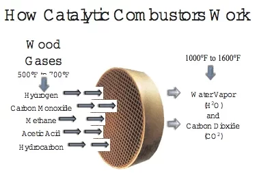

This interesting article was on a recent thread:
(broken link removed)
Below is a diagram of a working combustor:

Don't think that is quite the reaction I am getting in the Vigilant. More like all stuff going in and all stuff going out.
Might be time for a new cat.
The Vigilant is a non-cat stove. If it is burning poorly, it may need a complete cleaning.

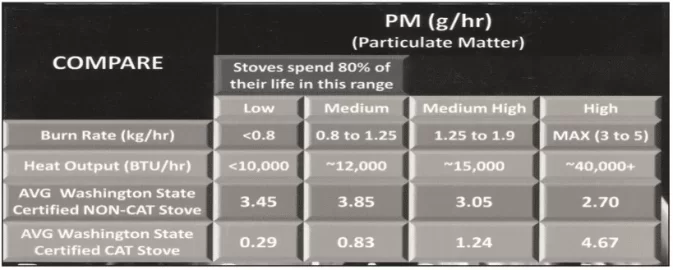

Not the best choice for full-bore burners like Remi and I anyway. See how poorly they do at a higher burn rate compared to a typical non-cat? The cat stove is more than ten times cleaner burning at low burn rates, but produces twice as much PM as a non-cat when running at maximum burn rates.
This table was part of a presentation given by Chris Neufeld, Vice President of Blaze King Industries, Inc. Nice of him to admit that a cat is not the final answer in all circumstances. What the table doesn't show, however, is how much more efficiently a cat stove is at burning off non-particulate matter. Methane, carbon monoxide, acetic acid, formaldehyde, VOCs, hydrogen gas, and a host of other substances produced inside the burn zone are not part of the EPA testing, but these are all fuel gases as they come out of the primary burn zone. These won't show up as "smoke" as they exit the chimney, either, so no matter what you see coming out, trust me, there is unburned fuel coming out clear as can be. The cats get most of this stuff to burn, thereby helping to boost the total combustion efficiency even higher than the EPA tests might predict.
