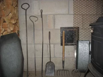

Tools of the trade for me (from left):
- Large bent poker (seldom used).
- Small straight poker. I forged this by heating it in the coals of my old stove and pounding it out on a piece of railroad track (my very first anvil).
- Small bent poker. This is used almost every time I reload, to lift and place splits once I've dropped them in the wrong spot through the top load door. Even though it was made for my old 118 style stove, the bent tip is the perfect size for scooping out ashes from in front of my intakes holes. The tip conveniently fits just inside the holes so I can unplug them even with a loaded stove.
- "Never-break" brand shovel. One came with every Vermont Castings stove. The guy I got my stove from threw it in with the stove. One piece, and... it will never break.
- Main hot coal handler is an old 6-tine garden cultivator that I cut the handle down on and ground the points of the tines off with an angle grinder. It is the perfect tool for moving a coal bed. One pull and the entire bed moves, leaving all the ashes behind to scoop up with the shovel (without mangling all the big coals into a mess of small ones that air won't pass through). Don't know where to find one, and I couldn't live without it. If anyone ever tries to steal it, I'll smash him in the head with the Never-break shovel. With my old stove I would just reach to the back, grab the unburned coals, pull them forward and lay three splits on top. Done.
- When I'm feeling particularly anal about separating out smaller coals, this commercial stainless deep fry skimmer is just the ticket. I only use it when there are almost no coals left and I don't want to start from scratch. There's always a bunch of small coals in there, and this little guy finds them. If I used it all the time, I'd get a bigger one, but this one is on loan from my kitchen (just don't tell Lady BK). $10 at the local restaurant supply place.
  • [Hearth.com] What do you do with a massive heap of coals in the morning?
