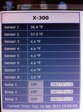

Look into controlbyweb. I finally ran the cat5 to my boiler in barn and tested the far run last night. Hopefully i can find some time to hook it up to the sensors on my storage tanks today.

I don't log.. but happy with the gear i bought from controlbyweb
