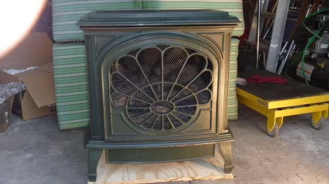

They also make vent-free gas log stoves. Not sure if only natural gas, or propane too. [Hearth.com] What do you know about Propane Stoves

I think you would want to be careful with those vent-free stoves, that would probably use a catalytic burner. The big problem with them is that without ventilation, they put out a lot of water vapor which may be a problem depending on the location. They are supposed to be safe enough, but I'm just not comfortable with that type of system.
But my only experience was with an RV version and it was very uncomfortable, so it may still be worth looking into them with that in mind.

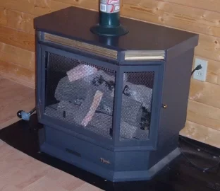

Duh! I just realized that I have a vent-free propane gas-log stove in my cabin! It was left there by the previous owner. I use it (along with my woodstove) to heat the cabin quickly when I arrive. I usually only leave it on for 3-4 hours, which is enough to bring the cabin temp up to where the woodstove can handle it. It has a thermostat, which turns the main flame on and off with room temp. I've only used that once, when it went down to 9 below zero (F) one night. The woodstove had trouble keeping up (cabin is not well insulated), so the gas logs would come on and off throughout the night to keep the cabin temp around 50.
Even though there is no wood to mess with, I wouldn't want to use the propane as a primary heat source. It lacks the woodstove ambiance and it has a mildly unpleasant smell. Nothing awful, just kind of chemical smelling.[Hearth.com] What do you know about Propane Stoves
