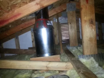

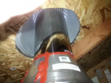

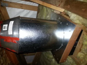

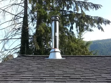

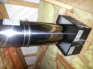

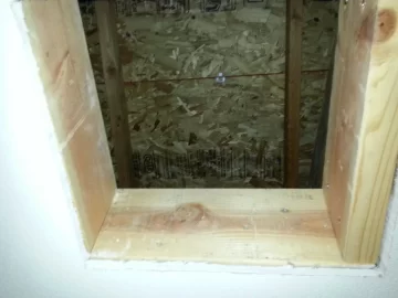

Well I took the plunge and moved forward with my first chimney install, I used all Selkirk components, don't know if I really needed the insulation shield but it's in there. All clearance to combustible are 2" or better, it has rained like hell here the last 24 hours. No leaks yet. Now to just build a hearth pad and connect from stove to chimney. What do You folks think? I am asking for opinions so critique away. Here to learn. Chimney is a straight shot from stove. 14' overall height. Thank you for your thoughts.

Hmm. Don't know if I got all seven pictures up...
hmm the part above the roof looks right. Not sure on the part in your attic. Should only have a ceiling support box that the class A locks into and maybe an additional insulation shield.
Yes, there is a 17" cathedral box, which the pipe comes through the bottom and is supported with a locking band and self tapping screws, then I framed around the cathedral support and attached the insulation shield to that. Does that sound better?
Looks right to me you didnt need to caulk the collar on the insulation shield but not a problem that you did
Well it just did to in the instructions to use high temp sealer.

Good job.
That was before the framing around the top of the cathedral box. Then the shield was screwed to that. Thank guys!
Really i stand corrected then None of the ones i have done have ever said to do it and there really should be no need. But if the instructions said to do it you did right
Nothing wrong with belt and suspenders too.
Reactions: Owen1508
All looks good, no need for the red silicone. Regular silicone is rated high enough to handle any temps that the pipe will reach. No biggie though. I've have also never seen an attic insulation shield require that the collar be caulked. Typically only the collar above the flashing needs this. I assume this is the one that the instructions were referring too.
right on that collar the sticker says to do that, yeah, kinda odd i thought, ugly to. But nobody will see it except on here. lol.

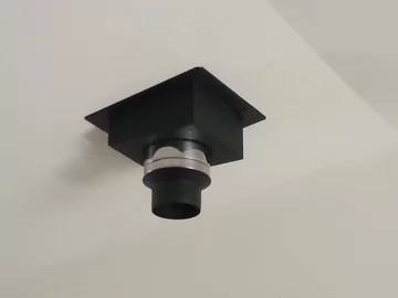

This is the ceiling side of things, i just finished that yesterday, now comes the hearth pad, and then the connection!:):ZZZ

You will just have to burn and see. If it burns good don't worry about it. You can always test by opening a window to see what kind of difference it makes. You can watch the chimney from outside and have somebody turn on your drier too. Looks like you are going to have a good season with that setup.
