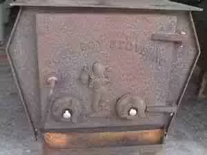

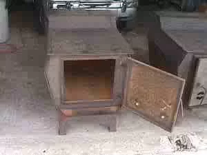

Rusty old stove like this off Craigslist.........
  • [Hearth.com] What do you think of this stove?
