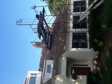

Well I've had some experience with chimney work...this was my 3 flue chimney last year. My Jotul is in a separate chimney.

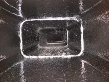

Got a little experience with the stuff myself. This the flue when I had my old insert. Glazed hard like a rock. The chimney fire to get it out was a sight to see.
[Hearth.com] What does creosote look like?
Do not try that at home.
That's nice bb cracks and all. And wisc woddy some people don't need their flue cleaned every year 4 years is to long for sure unless they hardly use it but we have some customers with good wood good stoves and and insulated ss flue that only need it done every other year. The recommendation is 1/8" of buildup and some times we don't find that. If that is the case we don't clean it and tell them we will be back next year. But once a year is a good rule for most people some need it more as well.
