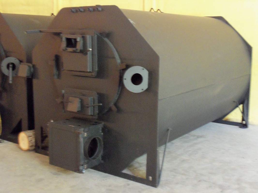

How about a pressurized garn style boiler?
I'm not sure but the Garn may be a non-pressurized Switzer-style boiler.
Looks like Gary's finally got a web page:
http://switzerswoodburning.weebly.com/
