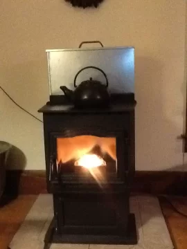

[Hearth.com] What gauge steel is used for a harman hopper extension? A friend who is retired from his family's metal fabrication business made me this hopper extension. He asked for $10 for materials. This spring, I will paint the extension black and change the handle to a more decorative one. It sits on top of the regular hopper and is attached with a clip. The lid to the regular hopper is still attached and stays open with the extension on.
Maybe he would be interested in making another for a few bucks?
