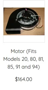

Not really, for motor and housing.. https://buckstove.com/store?olsPage=t/model-91&page=3

Maybe, but why get a new blower housing?
No reason, unless something was wrong with it but that's unlikely. At any rate, I think it's a moot point since he already got it.
