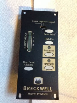

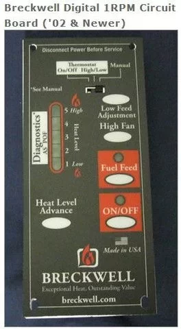

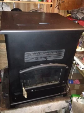

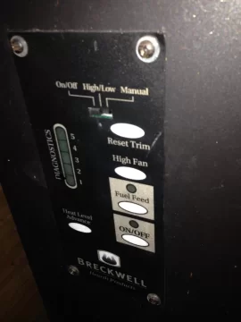

Time for a control panel upgrade!
I have seen 2 Big E stoves now without a surge protector. The control panel on/off light never stops blinking. It normally stops when the startup cycle is over and the run cycle starts. Also the convection blower does not increase in speed when the heat level is increased. The convection blower works on high fan only.
This is a result of not a very large power surge,
I did last year at this time see the same panel and a surge protector (a very inexpensive surge protector) both compeletly blown from a very high current surge in an older home in and older town just outside of Boston MA
The old control panel is black with white letters and light yellow around the on/off button and the fuel feed led.
The new control panel is black with white letters and red around the on/off button and the fuel feed led.

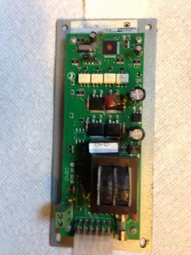

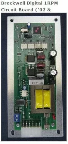

1. Does anyone know what the jumper does on the upper right in the back?
Default is pins 1 & 2 so what does pins 3 & 4 do?
2. What modifications and/or feature enhancements are in the new chipset?

Th jumper on the first two pins are for manual operation (no t-stat) If you install a t-stat (on the bottom left connectors) then the jumper needs to be moved to pins 3-4.
Are you sure? Pin 4 is broken off on the new board and the older board I have.
Maybe that is true for the much older boards?
I just check with Breckwell Dealer support
There are no enhancements or mods from the yellow to the red cover plate
The jumper is to change between the P22 stove which has 4 heat level settings and the other stoves such as the Big E that has 5 heat level settings.
The jumper on pins 1 & 2 select 5 heat level settings 1-5 and no jumper selects 4 heat level settings 1-4.
That is correct mine 1st info was for the Analog board. My misread. The Jump determines weither it is a 101 board or a 401 board.
