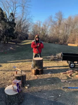

I'm 6'2 180 lbs and do the majority of my splitting by hand. I use an 8 lb Fiskars maul to break the big rounds then a 36" Fiskars splitting axe for the rest. Im splitting exclusively hardwoods like Maple, Oak, Ash, and Cherry... in that order by volume. Most of the rounds are 12 to 18" ish up to the ocassional big boy 24-26". Biggest log I got so far this year was a 26" cherry that was 8 feet long...tons of wood in there! My neighbor let's me borrow his splitter whenever I want but I enjoy hand splitting. A few beers and some friends and its a good afternoon.
Red Oak is by far the easiest to split. Barely have to try unless its got a big knot. Ash is also pretty easy but can be a little stringy. Cherry can be a bit of a pita as it's very stringy and tends to have wavy grain. Maple is a total gamble. If it's straight grained it's a piece of cake but it often grows twisted and knotted if it was a yard tree. Other random stuff I've gotten thats real tough is Box Elder...yuck...not worth the effort unless using a splitter.
For the big boy rounds I make sure any visible knots are on the bottom and on the opposite side of me. I look for a natural crack to start. Aim for the outer portion, not dead center. Keep the round on the ground so it's not raised up...you'll get more power. You gotta make a big old swing, big arc, and come down with everything you got. I find yelling helps and is cathartic lol. I've even jumped into my swings to get more power when needed. You do need to know when to quit though...sometimes it just isn't gonna happen. Let it sit for a bit and try again later or put it in the "needs a splitter" pile. Not every round is hand splittable but most are.
Proper technique, good equipment, alcohol, yelling, music, friends/family...all very helpful lol.
