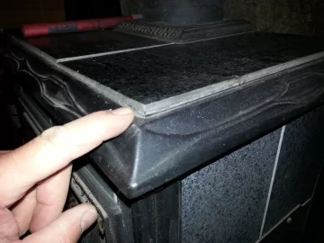

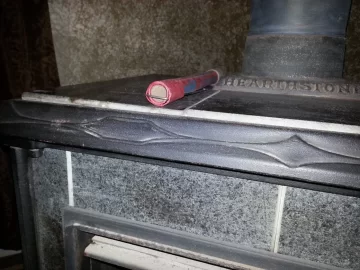

The top pcs of stone were not even. the extreme corners were lifted slightly and the middle , front stone was uneven. the right corner of it was higher than the left corner. I did not see signs of air and fire gasses leaking out, as there were no soot or creosote stains. Can these be re fitted so that they lay flat?

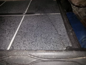

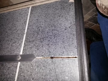

Two of the back stones had cracks in them and some dark stains between the stones show some leakage

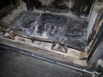

One of the metal "irons" that keep logs from rolling, was broken off (on the right)
See photo's and feel free to offer more advise. Main concern is the uneven top stones and the cracks in the 2 back stones...Also, how do you do a deep cleaning of the seconday combustion area? ATTACH]109664[/ATTACH] [Hearth.com] what is a fair price for a hearthstone heritage  wood stove[Hearth.com] what is a fair price for a hearthstone heritage  wood stove[Hearth.com] what is a fair price for a hearthstone heritage  wood stove

why would the top stones shift. perhaps from moving the stove from one house to another.
what about the cracks seen in the back stones?

That stove is about as burnt out and used up as a hearthstone can get. broken stones, broken andirons, creo leaking out of the cracks, paint burnt off, etc.
The uneven top stones have probably been that way since the stove was new. The top stones are just set in a mortar bed and knocked into place with mallet or by pressure from above. The fabricator just didn't push them all down evenly. Not unlike a poor tilesetter in a home.
As a "get you through the winter" stove it will be fine as is. It is certified and all of the damage is cosmetic.
