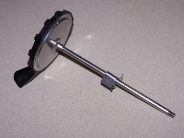

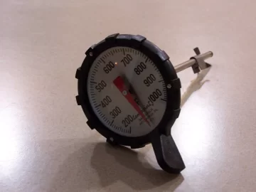

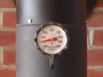

[Hearth.com] What is best thermometer to measure stack temps?[Hearth.com] What is best thermometer to measure stack temps?[Hearth.com] What is best thermometer to measure stack temps? Tempoint, easy recalibration as well.
