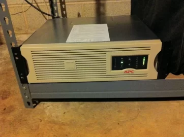

Battery Backup APC1400XL

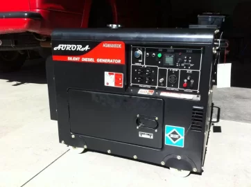

Aurora Diesel Generator - Portable 6500/7000 watt.
