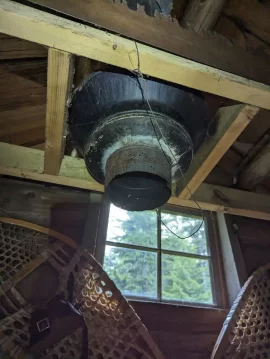

What is this?
tgillespie23
Oct 1, 2023
2
Vancouver
And where can I buy a new one? My best guess so far is a masonry adapter. It is between my stove pipe and the insulated pipe going through the cabin ceiling. Thank you!
[Hearth.com] What is this?
It’s the ceiling support box for the chimney. It’s also installed wrong.
The chimney support box and chimney pipe must match. Plan on replacing both. If the flashing is in poor condition, that too. I'm not sure where the best source is in BC. Canadian Tire has an odd assortment of DuraVent chimney parts. Same with https://friendlyfires.ca/.
Reactions: tgillespie23
Ok thanks, I'll YouTube installation on a new one.
It’s probably fine to reuse. It’s Selkirk/Supervent. The support box is supposed to be flush with the finished ceiling. Just needs moved to the bottom of the framing.
It looks massive. Probably has been working for ever. Just check the condition,
