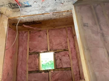

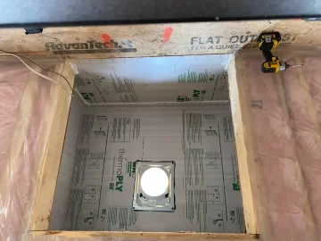

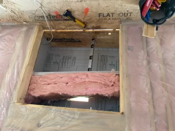

I have attached pictures of what a properly insulated and air sealed chase should look like.
Even when it is done properly, the design of direct vent fireplaces brings the cold outside air into the heated envelope of the house as combustion air. This cold air comes in through the coaxial( a pipe within another pipe) vent. The exhaust goes out through a smaller inner pipe and the combustion air is brought in through the larger pipe. The temperature difference of the cold outside air entering the warm conditioned space causes the cold dense air to drop and it is pulled by the pressure system of the house. It gets pulled through any openings in the outside of the fireplace( gas and electrical knockouts), and it can feel like blowing wind.
You can use foil tape to cover any penetrations in the lower cavity of the fireplace. This usually makes a noticeable difference.
