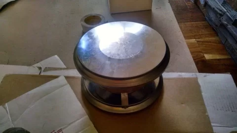

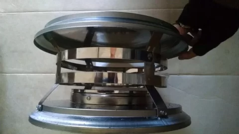

This is what mine looks like. Don't recall the manufacturer and I didn't get a pic of the box it came but it was installed with my solid Duravent liner Nov. 2014. The pro installer recommended not having a screen since he said it tended to clog up. No problems with any wildlife that I know of.

That's a simpson cap. I have two. When you buy them you can pay extra for a screen or buy it without.
Mine looks like FTG05s cap except it doesn't have those 2 round bands in the center it's just wide open which you can imagine leaves it open for wildlife. I would think those center bands will keep most wild life out.
