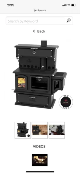

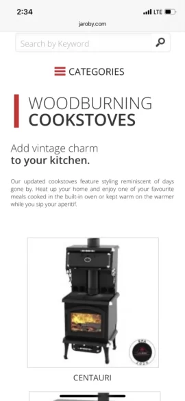

What make and model wood stove is this?

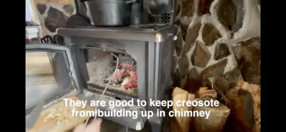

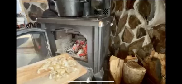

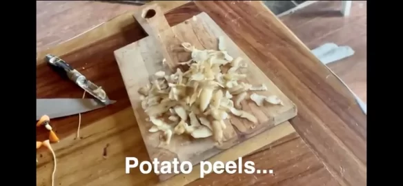

? And no.
They are wet.

Interestingly enough, this is technically true. The question is if the concentrations in potato peels and cans are high enough to have the same effect. Doing a spot check of the MSDS for three commercial Creosote remover products, the active/ingredient common to them is manganese acetate. (The actual percentage of manganese is withheld as a trade secret on the MSDS)
Both steel and aluminum cans contain manganese as part of the alloy (~ 0.35 to 1% manganese) and the average potato contains 0.3 grams of manganese (most of which is concentrated in the skin).
So potentially, they could work the same as the commercial products, converting the sticky tar-like creosote into the easier to remove flaky creosote.

Containing manganese does not mean it should work in a similar way. It all depends on the chemical form it is in when it enters your flue.
If manganese is all that's needed, buy some multivitamin...
I still believe that the loads of water in the peels in the pic would do more harm than any constituent chemical might reverse.

According to https://fdc.nal.usda.gov/fdc-app.html#/food-details/170032/nutrients, the manganese in just the potato skins is 0.023% by weight. If we assume that manganese in potato form and manganese acetate react with creosote the same way, and that creosote logs have only the same percentage of their active ingredient as aluminum cans do (both of which are pretty big assumptions), you'd need to burn 140 lbs of potato skins to get the same effect as one 3.2 lb creosote log. I don't think the amount of potato skins shown in that video are going to have any impact whatsoever.
